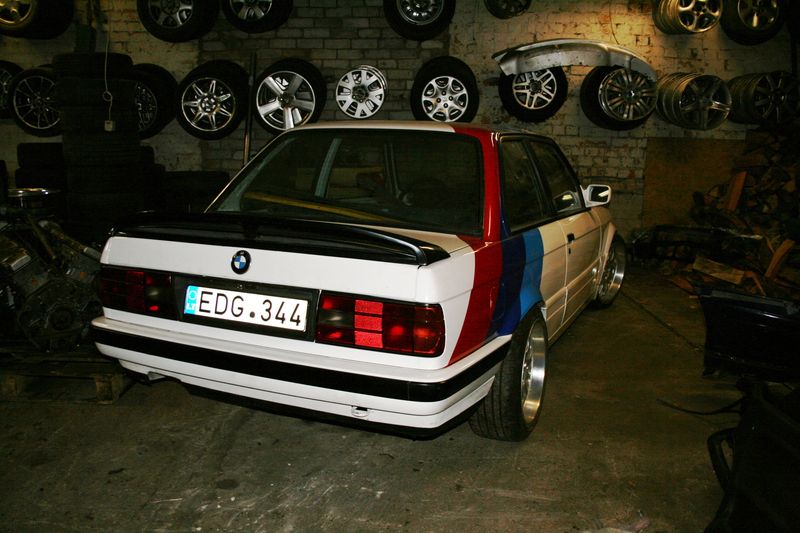

siek tiek plocio :)
ex BMW E30 4.4 V8 M'tech 2
next ...
Pawlaz
Posts: 37
Joined: 05 Sep 2006, 23:02
Re: Project: BMW E30 4.4ltr V8
Post by Pawlaz »
Gal biski daugiau prapute nei pas mane :) kiek j ir et ratai? posparni islupo ar paliko?

TomsiusBMW
Posts: 8
Joined: 10 Sep 2009, 23:50
Post by TomsiusBMW »
18 10coliu 15 etas jai neklystu :)
